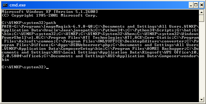

My PATH:
![[image]](images/uploaded/2017033018443858dd521693e69.png)

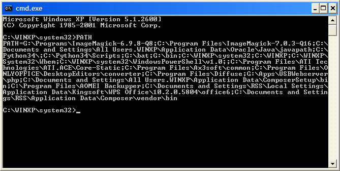

but it also works with both directories in the PATH:
![[image]](images/uploaded/2017033018463758dd528dbf0ed.png)
